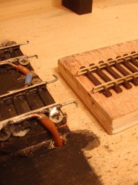

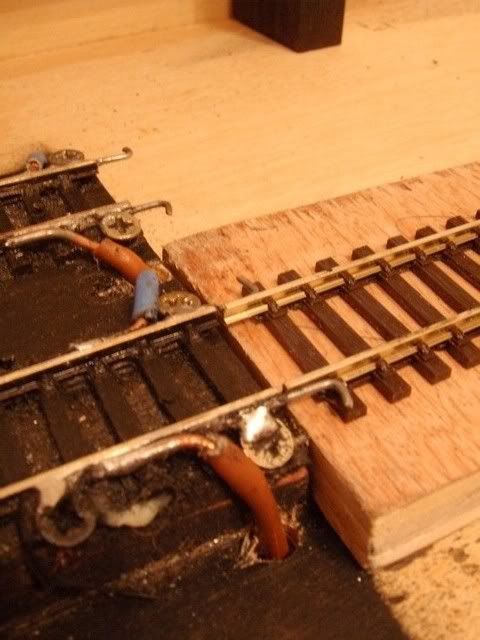

Well, the original idea didn't work out.............
There is enough play in the drawer slides to prevent the table lining up exactly with the entry track, it slops from side to side by about 1.5 mm. I have tried little tin-plate springs, ball catches and all sorts to no avail, as I can not get an alignment that is consistently good enough.
See diagram below [one picture is worth a thousand seconds wasted on XtrkCad]
Noticing that the table assumes a positive repeatable alignment at each limit of travel when it reaches the edges, I reasoned that a pair of adjustable stops at each side would provide accurate adjustment, but left the centre position still flopping about by 1.5 mm. Only having two traverser tracks is a no-no, as a loco could not run-round a train to pick up another, so I've decided to try a turnout leading to the traverser, as in the diagram below. In this scenario, only two pairs of stops are needed to allow three roads to be accessed. Further more.........at the limit of travel in each direction, the inbuilt 'inertia sensing auto drive-limiter' cuts in [the drive belt starts to slip...] indicating exactly the moment to release the button!
So, a new idea, just got to see if I can make it work...............

Having had a break from the cellar during the colder weather I set to Wednesday and took it all apart, increased all the clearances, stuck some cork down on the table and made up some cams by cutting out 4 circles of laminate flooring with a small tank cutter, soldered up some curved extensions to a Peco turnout and today played around until it all seems to work. In the photographs, the rails are held down with drawing pins during the trial. I'll go round now and replace all the 3.5 x 20 mm screws in the construction with 4 x 25 mm, add some fillets of PVA here and there, lay cork at both ends where needed and fix down my first piece  of track that leads off of the traverser.......:Happy

Now you've got your track coming off your traverser the fun can begin!!!(Lets see some trains!!!;-))

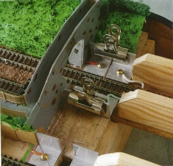

One of the trickier bits of installing point motors IMHO is keeping the motor in 'mid-position' whilst marking and drilling the fitting screw holes. Suggestions include cutting a little piece of slotted card to slip over the actuating arm, making a blank pattern of the base plate and so on. The card drops out. The pattern doesn't have a pin sticking up in the right place for an 'eyeball' test.............aaaarrgh!
So, I have altered one of SWMBO's clothes pegs by turning it inside out and cutting two differing sized slots in the 'handle' end of the peg to slide around the spring on one side of the moving part and the actuating arm on the other, see below. It keeps the actuator in mid position and doesnt drop off onto the floor. TaDaaaaaa!  I've decided that pushing two bits of card either side of the moving rails to centre them works best for me.

who is a clever boy then, neat trick where were you when i did my
37 point motors then????
:doublethumb:mutley:mutley:mutley:cool:

Brilliant!  Quite a handy way of holding on when soldering as well!

I used pieces of for my cassettes I soldered it to the outside faces of the fixed rails with no problems, then bent it in slightly to make contact on the outside faces of the cassette rails.
Or another idea I have seen used is a surface mounted barrel bolt
Mount the bolt on the fixed side and 3 "keeps" on the traverser. If you get a braas barrel you can solder a feed to it then, solder each of the traverser tracks to the relevant keep. That gives you posotive location for the traverser and feed to the selected track. Only one rail needs to be fed via the barrel as the other rail can be linked and fed via a flexible cable to the feed rail.
Just realised the traverser is fed by more than one feed track, but Im sure a combination of barrels could sort that out.

IT WORKS.............It ain't pretty, but two into three does go, after lots of messing about with home made switches etc, I went back to the first idea of contacts that move with the table.
Each end of the traverser trackage is looking pretty sorry for itself after all the soldering/unsoldering, and though it has worked throughout an hour of playing 'shunting puzzles' I'm not sure. Plus, I've lost the little lift up tension lock hook from the stern of my 45xx, it seems to have pinged out some where.
Herewith, some piccies of the prototype wiring, I can move side to side, uncouple, using plastic strips, swap locos from train to train and end to end etc. Now I must try and repair the damage to the track ends, perhaps cut out and insert a new bit in the middle of each traverser track and re-trim the part where they meet the fixed ends......perhaps, maybe.....

It is actually quite pretty, dd.  Dumb question from me, "Why so many rail contacts?" - or are you using DC?  Told you it was a dumb question . . .

Doof, while it looks a bit "Heath Robinson", it looks a good working unit & by the time all is tidied up, you should be very proud of it.

MaxSouthOz wrote: It is actually quite pretty, dd.  Dumb question from me, "Why so many rail contacts?" - or are you using DC?  Told you it was a dumb question . . . Hi, Max,
There are so many contacts because each individual rail of  traverser track 1 and 2 have to be connected in the 'left' position with each individual rail of the two approach pair of tracks, and then in the 'right' position each individual rail of traverser track 2 and 3 have to be connected to the two approach pair of tracks. O.K? Are you still with me, pay attention, you asked for this....and no sniggering at the back.............:shock:
Now it gets complicated!  Remember, the four rails of the two tracks approaching the alternating traverser rails will be polarised by the point switching to
+........- , -.........-  in the straight-on position, and +......+, +......- in the turned-out position so there can be no 'common' rail connections.
What has been occupying my time has been
1    An attempt to make 'tin' contacts fitted to the ends of the rails to carry the point-switched current,
2   and several wasted attempts to design a switch unit to do the job of the contacts in absence of suitable phosphor-bronze spring material for the contacts.
Now I've done it 'in the rough', I'm still not satisfied and I'm wearing my thinking cap again.
Still, I did have a couple of hours of 'playing trains' last night! :doublethumb

If you are going to build a mark 2 version, you could always use aluminium angle instead of track, use a bulldog clip to connect and do away with the complex wiring altogether. Our club use a simular method for energising the casette system we use, so let me know if you want some photos when I go tomorrow evening.
Here's one photo which illustrates the method, the second of the two lengths of angle is attached to the "traversing lines" :-

Hi, Gang!
As usual, one step forward, one step back....you know if it were to rain Oxtail soup, my bowl would be upside down......
The nylon buttons [sliding on, for the use of, four in number (for those of you who have done national Service etc...)] did not work, I'd have needed the motor from a Dyson to turn the table should I go down the electro-draulic route instead of hand-draulic,
so,
back to the drawing board.
All turn tables run on wheels. Where to find wheels?.
Drawer stops, yes, sliced up drawer stops from M.F.I. furniture, see piccy 1, sawn [very carefully] with a Yappanese pull saw, the silce pressed into a counter-bored hole in a piece of flat tree and then pared flat with a paring chisel, in this case my Dad's old pear-wood handled 5/8" paring chisel . See piccy 2.

Well, an afternoon off yesterday, thought I'd do a bit of turntable, but first......max brownie points, this is a piccy of SWMBO's special birthday meal, salmon with asparagus and Hollandaise sauce wrapped in puff pastry and a Doofer style prawn cocktail.
The brownie points lasted 48 hours until I strimmed wet grass next to clean washing on the line:shock::shock::shock::shock::shock:
Right, back to the TT.
This is the first go at wiring up and trying a loco on the table rail, all worked!
There is no need to do the reverse thing for the 'lectrics, 'forward' when you drive on is forwards off. What happens later is any one's guess.......
First, to make sure the turning table rails were exactly the same length, I put a disc in my mini-drill and, holding the disc and drill firmly in the right place, gently turned the table round until all the four rails were ground to the same length.
I soldered down the first entry/exit rails to brass screws, fixed the revolving table to them with a piece of grooved wood, drilled holes to accept more brass screws brass screws and fixed the opposite rails similarly. I chose 60mm lengths and cut away all but 6 sleepers, and removed the webs and joiners between them to that they could be slid up and down whilst I soldered the rail to brass screws set at the right height. That prevented the sleepers being too close to the hot bit, and kept the gauge well without melting them.
For the first 'extra' entry/exit and in order to make good sense rail geometry-wise, I stuck two bits of rail onto a turnout with rail joiners and laid it on top of the table rail. I carefully marked where the extensions lay across the outer fixed part of the table.
That gave me the 12* angle for the next entry/exit track, which hopefully will align nicely with a three rail feed constructed with the 12* Peco pointwork.
                                                                                No photos to restore. . . . B
That's how, Peter., right first time!
